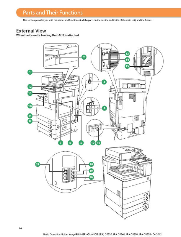

I don't know where to start does anyone have a maintenance manual for the C5240 or what to do to fix this issue?
Basically need to know if its directly located by the power connection on the back or which doors/ panels to remove to unplug all connections and replace the power supply.
